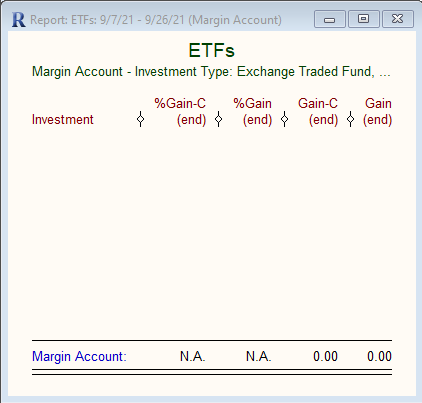

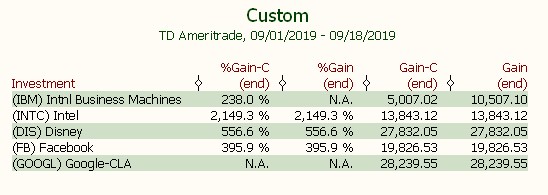

Is that how the report window looks too? Can you send a screenshot of your report? The "(end)" is part of the column labels, and should be above the rows of your actual listed investment data, like this:
Screenshot 2021-09-26 182541.jpg (33.18 KiB) Viewed 4673 times
Postby chris319 » Sun Sep 26, 2021 7:17 pm
Here is the screenshot. Scroll down to see the whole thing.

It is formatted fine, but there are no investments listed. The header is showing there is a filter on, so that the report is only listing Exchange Traded Funds in the "Margin Account" sub-portfolio. You can turn off the filter by going to "Edit / Filter Settings..." and set "Filter By:" to "<no filter>".
Postby chris319 » Sun Sep 26, 2021 8:43 pm
That is exactly how I have it set up and exactly the kind of report I want. At the moment all the assets in this account are ETF's except for the missing AVGO and cash.

Postby Mark » Sun Sep 26, 2021 9:26 pm
It appears they are not assigned to this investment type since they're not being displayed. You can check their investment type under "Investment Properties... / General / Type:", and make sure they are set to the desired type, matching your filter.
Postby chris319 » Sun Sep 26, 2021 9:48 pm
OK, double checked the investment types and all is well now, thank you.
