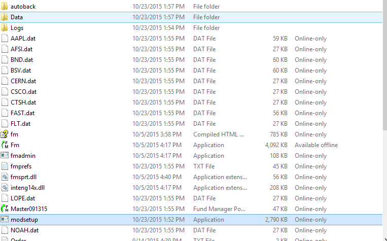

Postby John Lea » Fri Oct 23, 2015 12:29 pm
This should be a capture of the directory in the cloud
I believe I have been clicking on the FM.exe in the cloud under "users". One thing I noticed is at that level it is called Skydrive .
Another thing is that I restored a portfolio that was on the PC. I am pretty sure I restored it to the cloud rather than the original location.
John Lea
Posts: 45
Joined: Tue Oct 14, 2008 3:43 am
Postby Mark » Fri Oct 23, 2015 12:53 pm
Hi John,
Looks fine. I would suggest using the "File / File Operations / Set Data Location..." to store all your data in that "Data" folder instead of in the same directory with the program where it appears to be now. Just double click on that Fm.exe (your extensions are not being show, so it just says Fm in the screenshot) to start it. If you have troubles still, maybe a phone call would be in order.
