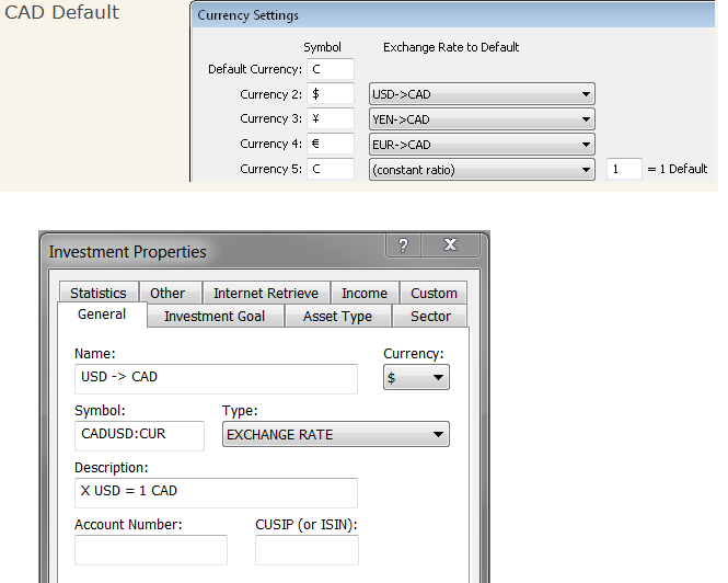

Postby ThomasK » Tue Feb 02, 2016 11:54 am
I'm in Canada.
I'm getting under the hood of FundManager just to make sure all is set up well. My Default Currency is CAD and trade in USD. I finished reviewing the help files. So, just to make sure, is the following set up correctly?
1. Currency Settings, I'm using as per the image where Default = C and when View/Exchange Rate Adjusted is turned ON then then Currency 2: USD -> CAD kicks in. I get that.
2. I set up the USD -> CAD investment as displayed in the image...My question is on the symbol selected for the Currency...it should be the one for USD "$" yes? Not the one for CAD...yes?
3. I wanted to see if the updates were fine. Retrieval is via Bloomberg. Where would I see this?
4. How does Fund Manager know to use this file? Can I move the Investment around in the Portfolio Editor?
Default + Second Currency Setup.png (27.01 KiB) Viewed 2417 times
Postby Mark » Tue Feb 02, 2016 8:39 pm
Hi ThomasK,
1) Looks good.
2) The currency you assign to an exchange rate investment really doesn't matter. It can be anything.
3) Look at the investment in the Data Register under the Data Type of "Prices".
4) Yes, you can move it around. It will keep it assigned no matter where you keep it in the sub-portfolio tree, as long as you don't close it.
