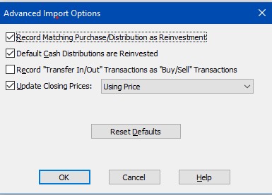

I could edit while importing, if that's what's required. I was just poking around and I wondered if checking the unchecked box in this screenshot would fic things (though perhaps it might cause other problems).

Postby Mark » Sun Aug 29, 2021 11:21 am
Hi johnkirin,
Yes, when the memo starts with "(Imported)" this is an automatic default cash account entry from an imported or retrieved transaction.
On the screenshot you sent, there is one related option, which is "Record Matching Purchase/Distribution as Reinvestment", but it won't combine a Transfer/Distribution into a reinvestment, so this wouldn't work if your broker is reporting it that way.
