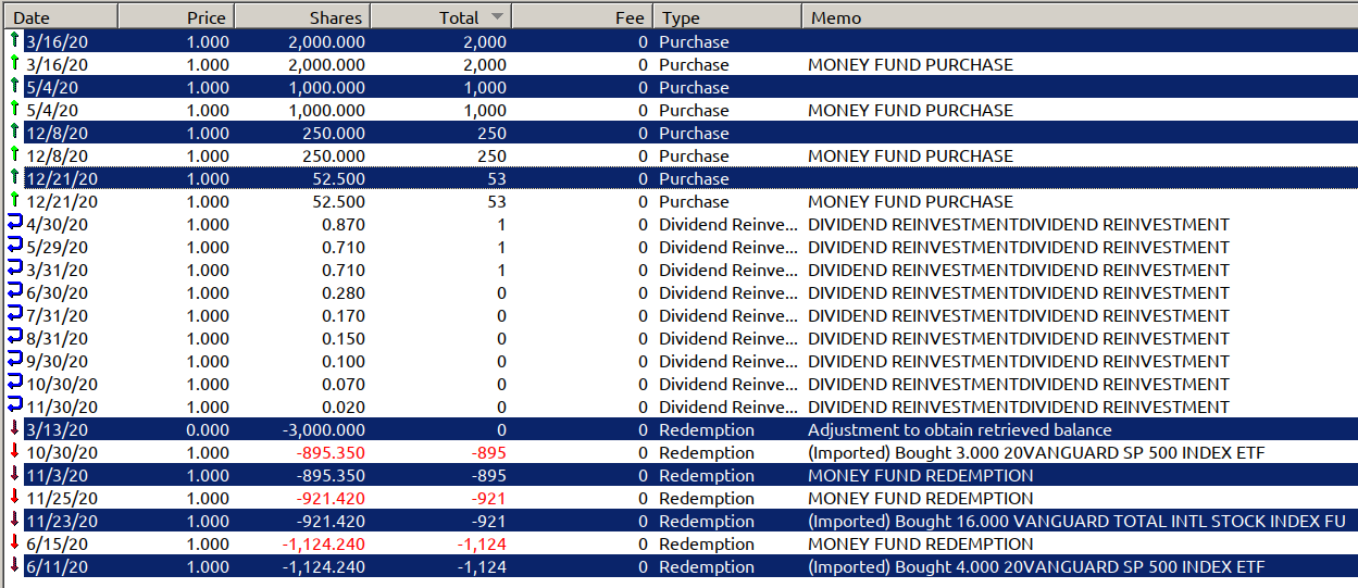

Postby randomfive » Sat Jan 02, 2021 12:40 pm
Thanks for your response!
I watched the video and as far as I can determine I'm following all the instructions already and have the check boxes selected as per the screen image.
I'm attaching here the transactions in my basic UTMA account that has little activity and has not been open that long. All the lines I've highlighted need to be deleted in order to equal the correct balance.
Do you have any suggestions for how these transactions were generated, all but one being a duplicate?
Thanks!

Postby Mark » Sat Jan 02, 2021 12:53 pm
Hi randomfive,
It looks like you are using this money fund investment as a default cash account, but your broker is also reporting these money fund transactions specifically. In this case you are double recording transactions in the money fund. So, either don't use the default cash account feature, or use a separate cash investment from your money market as a sweep cash account. Take the example where you bought something for $895 on 10/30.
You can either record it without a default cash account like this:
10/30 Buy ETF for $895
11/3 Sell Money Fund for $895
Or, if you use a sweep cash investment (a separate investment from your money fund that will end up having 0 shares once things settle), record:
10/30 Sell Sweep Cash for $895
11/3 Buy Sweep Cash for $895
Notice, the "Sweep Cash" will end up with 0 shares.
Postby randomfive » Sat Jan 02, 2021 4:12 pm
Thank you for solving my problem, and for responding so rapidly. Much appreciated! I am choosing to turn off the default cash reporting.
