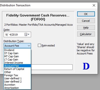

When I try to edit the existing transaction I do not have the ability to change it to a sell (see below.) It looks like my only option is to delete the transaction and manually repost it. Please tell me there is an easier way to do this...
Thanks!

Postby Mark » Wed Oct 02, 2019 9:34 am
Hi WeekendRider,
Sorry, you can't currently edit a Distribution to become a Sell. You would have to delete and add as you described.
We will be releasing Fund Manager 2020 very soon, and that will add the ability to edit transactions in the "Preview Importing Transactions" dialog. So, during import you can edit this distribution. With this feature you can change it from a distribution to a sell.
Posts: 11772
