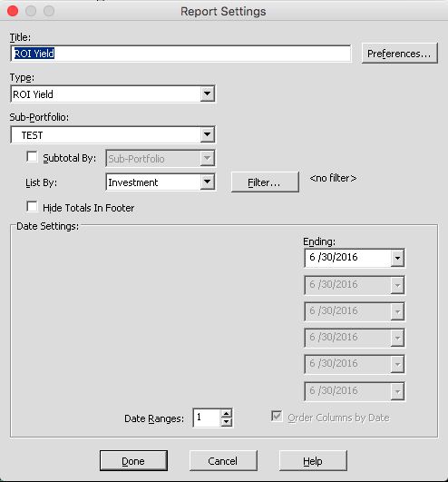

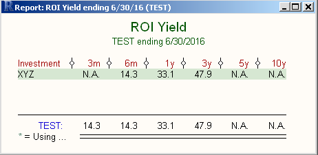

I'm trying to better understand the ROI reports. I created a clean portfolio and imported the attached data with settings. I am seeing NA for the 3mo ROI. There is a yield listed for the TEST portfolio. What causes the NA for the fund ROI?

It is often due to insufficient pricing data. You need to have pricing data at the beginning and end of the yield term. Your interpolation range settings control how flexible Fund Manager will be in interpolating missing price points. To find the exact reason for the N/A use "Help / Report Calculation Log..." while viewing this ROI Yield report.

Thanks for the quick and helpful reply. I looked at the error log, added a price for 3/31/2016, and the NA went away. I'll now know how to debug this problem in the future. I'll likely make sure to have monthly prices and avoid the issue altogether.
