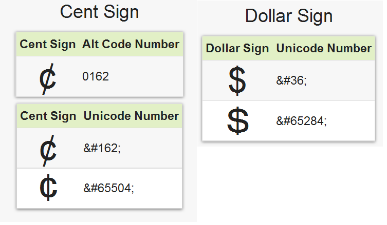

Hmmmm, what about when we cannot insert the cents symbol via the keyboard but instead are forced to do it with an ALT code? Perhaps it actually was the "$" that I used from within Excel?
What "are" the codes Fund Manager uses? I found the website: http://www.alt-codes.net/currency-symbols and pasted a picture.
Thomas

Postby Mark » Mon Mar 21, 2016 12:03 pm
Hi Thomas,
Fund Manager doesn't use any specific codes for currency symbols. You set these under "Options / Currency Settings...". Fund Manager only understands ASCII characters, so you can't try to enter a Unicode character. Whatever ascii character string you enter for the currency symbol under "Options / Currency Settings..." is the same ascii character string you would enter in your importing file for the CURRENCY.
If your ALT code is 255 or less, this may be okay, and would be an ASCII character. The regular displayable ASCII characters are from 32 to 127. From 128 to 255 are extended ASCII characters, and the symbol displayed can vary by selected font. Until you get it working I'd suggest just sticking with a few plain ascii characters you can type without the Alt key method. You can do all your importing with a currency symbol like "cents" and then change it later, once you are done importing. If you plan to continue importing then this wouldn't work, but you can at least try to get it working first, without the complication of using extended ascii characters. Unicode characters will not work at all.

Postby ThomasK » Wed Mar 23, 2016 6:25 am
Thanks Mark.
So I understand this a bit more, how did you create the British Pound symbol? It is outside of even the extended ASCII at least according to the Wikipedia info whereas the 'cents' symbol is as you said, in the extended set. Ha ha, I even forget if the cents symbol I'm using was part of the FM default or if I created it. Hmmm...
As I want the currency symbols for CAD and USD to be just 1 displayed character this sounds best to revert to "C" as in the tutorial if need be.
Postby Mark » Wed Mar 23, 2016 7:39 am
Hi Thomas,
The British Pound symbol (£) is created with Alt 156. It is in the extended ASCII range. The cents symbol isn't in our default settings for currencies.
