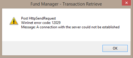

I downloaded the latest transaction module but received the error message below. A couple of questions about the Vanguard download process, going forward:
1) I have several accounts at Vanguard. Given the number of re-tries the new module performs, will this lengthen download times?
2) Is this a one-time issue with Vanguard, or do you expect FM (with the latest transaction module) to repeatedly try up to three times each time I wish to download?
3) What do you recommend I do to fix the problem below?
Postby Mark » Wed Sep 10, 2014 4:05 pm
Hi Aviator,
It may slow down slightly when it has to make multiple requests. If Vanguard fixes their OFX server, it will automatically go back to being faster, as it only makes additional requests if the last one returned a signon invalid error code. It does not always make 3 requests. It makes a request, and if that succeeds, that is all that is done for that account. Only if a request returns the signon invalid error message would it re-try. Once you fix that other error you can see for yourself if you think it is any different in speed.
That 12029 error message is probably coming from your firewall software on your PC. When you update Fund Manager, it is downloading a new DLL which is making the requests. Some firewall software programs block new programs by default, so you may need to inform your software firewall again that it is okay for Fund Manager to access the internet.

Postby aviator » Thu Sep 11, 2014 3:14 am
I attempted another download this morning and it worked! No error message and no failed portfolio retrievals. Thanks for your responsiveness, Mark.
