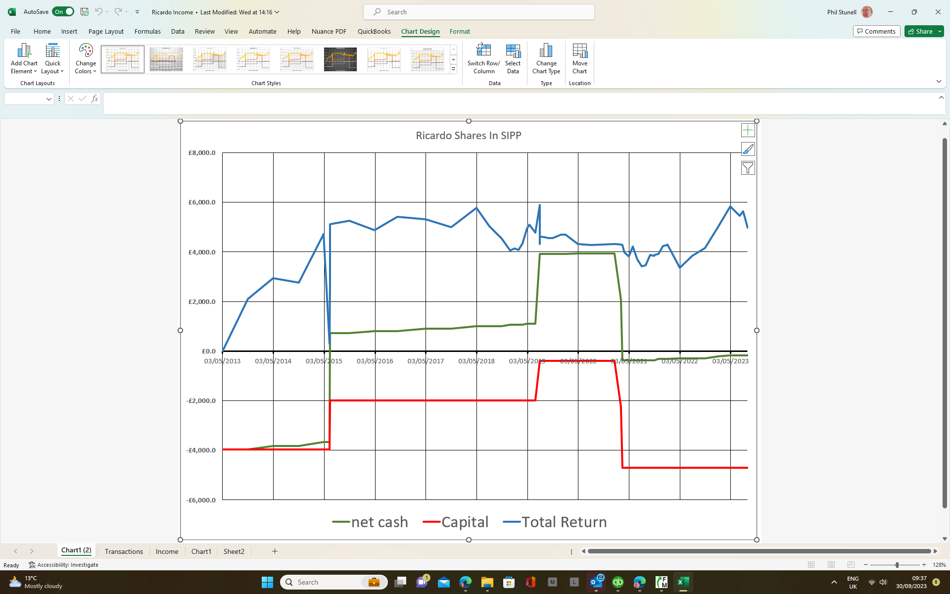

Postby philstunell » Sat Sep 30, 2023 1:43 am
This is an example of the graphs / figures that I would like to generate.
Ideally, the share / unit price would be shown in separate window above this graph.
It reveals not only the performance of the share, but the impact of my decisions on the portfolio's performance.
Phil

Postby Mark » Sat Sep 30, 2023 10:36 am
Hi Phil,
Okay, thanks for the idea/information. These aren't available today. You can get value, price, price + dist, and OOP cost (either per share, or in value terms). Maybe we could do something like a user-defined plot, which would work similar to user-defined custom report fields, where you can write an Excel like equation to plot what you want.

Postby philstunell » Sat Sep 30, 2023 3:20 pm
I think the Net Cash Flow = NAV + Distributions (so that is available)
Total Return is also available, so not a problem.
The surprising omission is the cost of assets held.
As, I think, this is required to work out the taxable gain on sales / redemptions - I think the information probable exists, although it is not presented.
regards
Phil

Postby Mark » Sun Oct 01, 2023 8:45 am
Hi Phil,
FM will calculate both your "taxable" as well as what we call your "Out Of Pocket" cost basis. However, it will only graph the OOP basis. It doesn't plot the taxable basis, although this figure is available in the reports and Portfolio Editor.
