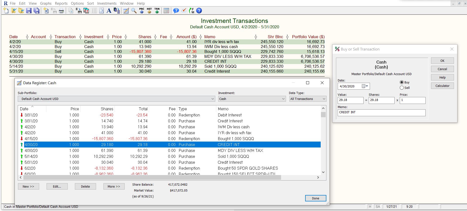

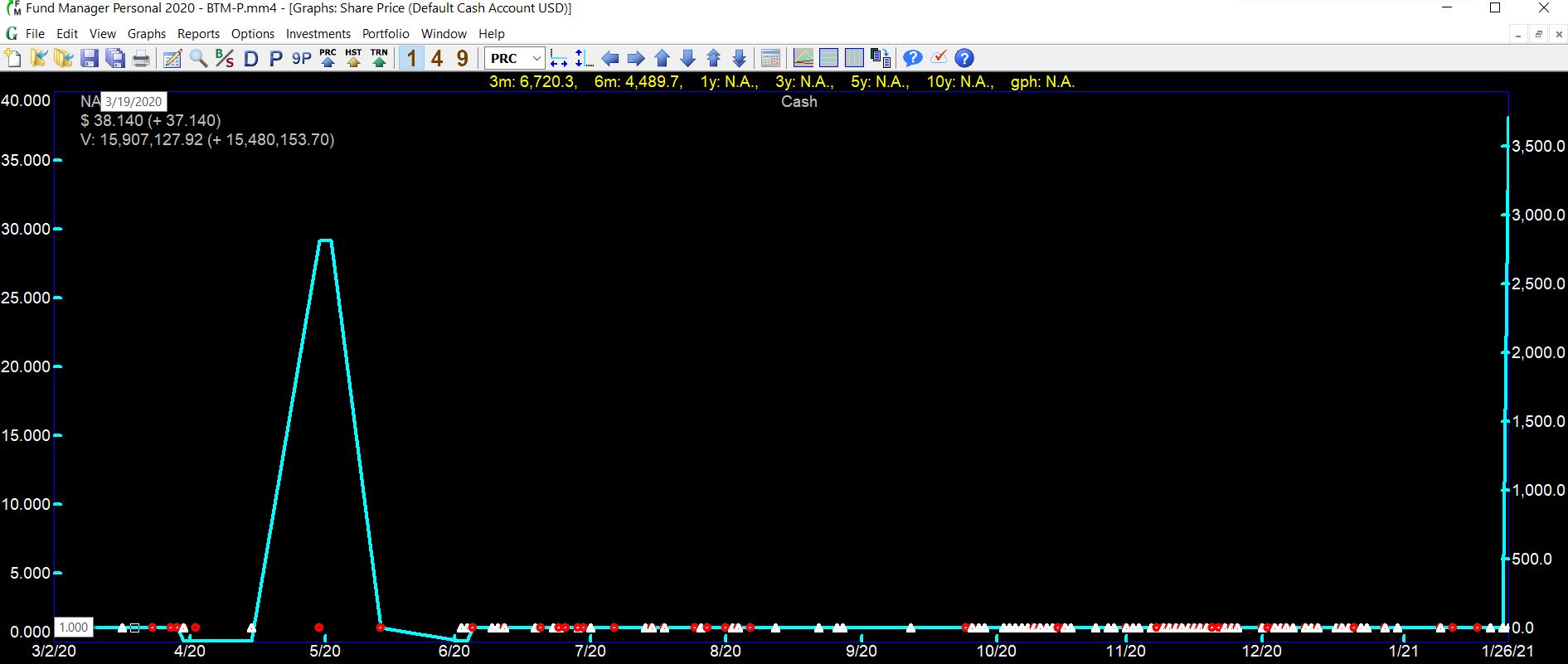

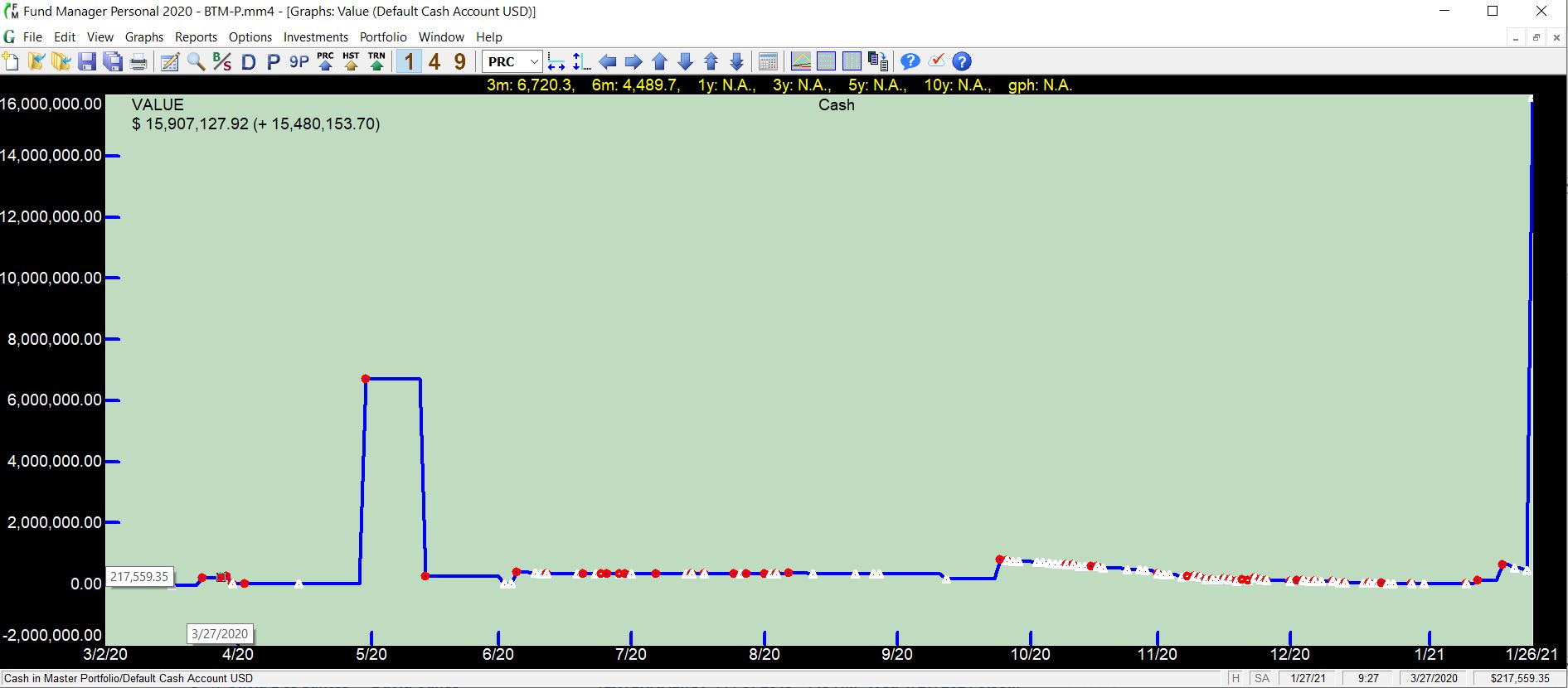

Postby ZOO55 » Tue Jan 26, 2021 7:15 pm
1) What graph type are you referring to?
All graphs (value, gain) that include the Default Cash Account individually or as a component of the entire Master Portfolio have this bug.
2) Did you look at the "Prices" for your cash investment? Are they all 1.00? Make sure you are looking in the Data Register under the "Data Type" of "Prices".
Yes. All prices entered are correct in all registers. The Reports correctly show $1.00 price for all transactions and correct number of shares, but also the wildly incorrect portfolio values. However, I just today happened to check the Default Cash Account share price graph (before, I have checked only PORTFOLIO value and gain), and it has two giant anomalies: During the period we are discussing, shares price spikes to $30.00. And now, just today, it spiked to $38.140! Again, the registers all show correct entries on price ($1.00).
3) Do you have the option turned OFF to retrieve prices for your cash investment? See "Properties... / Internet Retrieve / Retrieve Price".
I had never checked this before, it was "Off". I turned it "On" and clicked "PRC" to retrieve prices just now, and then this crazy $38.140 price shows up.
I will upload three screenshots that will be self - explanatory. I hope all this helps. Thank you.
Cash Account Transactions detail .JPG (255.37 KiB) Viewed 10600 times
Cash Account Share Value.JPG (123.48 KiB) Viewed 10600 times
Cash Account New Value After Update Jan 27.JPG (142.05 KiB) Viewed 10600 times

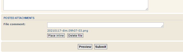

Postby Djobydjoba » Wed Jan 27, 2021 1:00 am
You can delete yourself the attachements you've posted:
Click sur "Edit" button at the top of your post:
Then Click sur "Delete file" button(s), and click "Submit"
PS: "Place inline" means insert into the text. If not placed inline, the attachments will be displayed at the bottom of the post. So as soon as an attachement has been posted it will be visible, and have to be deleted if you don't want that.
Posts: 825

Postby Mark » Wed Jan 27, 2021 9:30 am
Hi ZOO55,
It looks like the problem is #2. Your prices are not all $1. You showed the Data Register with the "Transactions". Yes, all your transactions are recorded at a transaction price of $1, but you need to look under the "Data Type" of "Prices". Market prices are separate from transaction prices. In the Data Register, look in the upper/right, and under the "Data Type" dropdown, select "Prices". Make sure all your closing prices for cash are set to $1.
Also, you do NOT want to retrieve prices for cash. The option to retrieve prices for your cash investment should be OFF.
