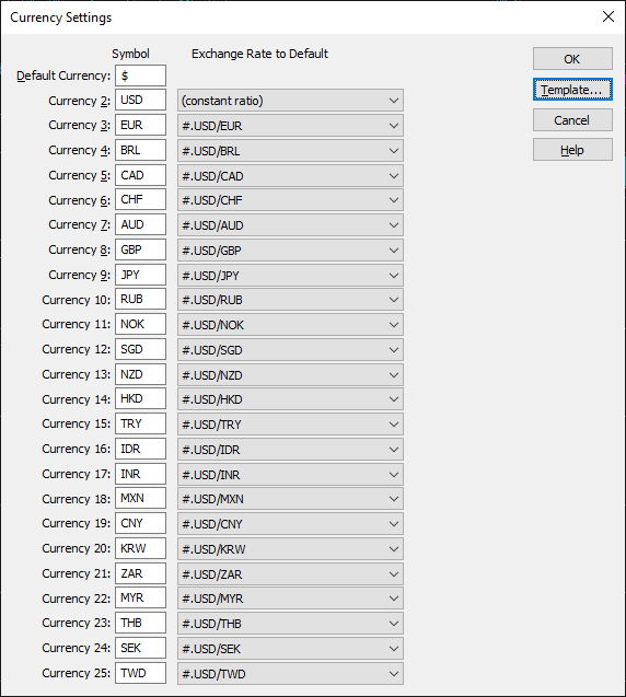

I'm still not happy with the way trendlines are implemented with currencies and currency templates.
To explain again my problem with the current implementation (summary of our past discussion above):
- I track many investments in FM and of course they can have different native currencies.
- I have set up the currency settings to be able to convert each of these native currencies to my default currency (which is €) with the "Exchange Rate Adjusted" button. This setup is saved as the EUR Template
- I have created too an USD Template to be able to convert each of the native currencies to another default currency which is $, because $ is the international reference currency, and I find very useful to analyze graphs in this reference currency too (an outstanding feature of the program btw)
Here are my currency settings for the EUR Template and the USD Template. Nothing special, standard way to set things I think.
EUR Template.png (31.1 KiB) Viewed 4430 times
USD Template.png (30.83 KiB) Viewed 4430 times
You can see I use 3 letter codes for the investment's native currencies, and the symbols € and $ for the default currencies. This way I find it easier to see in the program:
1) if the investments have a native currency assigned or the default currency assigned (the last when their prices must not be adjusted with the "Exchange Rate Adjusted" command)
2) when "Exchange Rate Adjusted" is on or off
So, for market analysis, I very often switch between "Exchange Rate Adjusted" on and off and between the EUR and USD templates. So there are 4 situations where I draw trendlines:
1) "Exchange Rate Adjusted" on in EUR Template
2) "Exchange Rate Adjusted" off in EUR Template
3) "Exchange Rate Adjusted" on in USD Template
4) "Exchange Rate Adjusted" off in USD Template
What I would want is to draw trendlines without having to think of the current situation and that the trendlines to be displayed in all and only situations where it is relevant.
For example:
- in the situation 4 above, I draw a trendline on an investment whose native currency is EUR. So this trendline should appear too in the situations 1 and 2.
- in the situation 3 above, I draw a trendline on an investment whose native currency is EUR. So this trendline should NOT appear in all the other situations.

For what it's worth (and for the fun, because I like to think about those things :) ), I have thought of a modified implementation, certainly with flaws too and improvable, but I think better than the current. I hope you will find it useful to rethink the implementation.
First, a table that summarize the various situations:
And, below pseudocode on how things could work, roughly (I am not a coder so be forgiving)

Posts: 809
