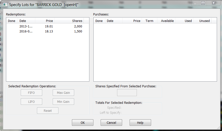

Postby ThomasK » Tue Sep 27, 2016 11:27 am
This is from Investment Data / Specify Lots for a stock price chart that shows the purchases as "specified" (ie not having the green circle around the red marker)
Specify Lot Issue.PNG (63.69 KiB) Viewed 4989 times
That makes sense.
So, most likely the few stocks that show "specified" (ie not having the green circle around the red buy marker) were bought/sold via Specified Lots or FIFO.
When I pull up Investment Data/Specify Lots for a stock that is UNspecified, no shares are listed in either Redemptions or Purchases.
How best to "unspecify" shares as in this example?
Thomas
Postby Mark » Tue Sep 27, 2016 11:57 am
Hi Thomas,
If nothing is listed in the "Redemptions" box, then you haven't sold anything, and there is no need to do anything. In that picture you've sold 2 lots, but haven't specified them, so no un-specified lot markers will be shown, since you have sold some shares, but haven't specified which shares you sold.
Posts: 11839
