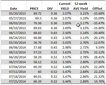

Hi Mark, Is there a way to create a custom formula that calculates a running 52-week average yield for a stock? Here is an example of what the report would look like, the objective is to find out if the current price is at attractive yield for reinvesting dividends. Trying to calculate the last 3 columns shown in the attachment. (Also I do have the income dividend populated for these stocks). Thanks very much.

Postby divinest » Mon Oct 09, 2017 2:59 pm
Hi Data8504,
Thanks for your response.
Apologize, i should have explained the col defn bit more
Date - is the weekly date (can be any week day of the week, but mostly one line item per week)
Price - is the price of the stock on the given date
Div - is the last quarterly dividend
Current yield (Div x payout frequency) / Price
52 Week Average Yield - is the rolling 52 weekly average yield (same as current yield, but the average of past 52 weeks)
Offset is the different between the current yield and rolling 52 weekly average.
The Objective:
Lets say i have 20 stocks in my portfolio, i would like to reinvest all my dividends, however i don't want to DRIP, instead i would like to see which of my currently held 20 stocks has the highest current yield in relation to the past 52 average yield, that way i would reinvest to the position that is trading at the lowest price versus in relation to other.
I could do this in excel, however that is time consuming, so trying to see if i can create custom formulas in a report to show the same results. Thanks much!

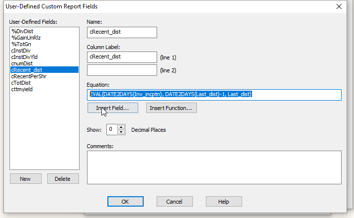

Postby divinest » Mon Oct 09, 2017 5:50 pm
I am trying to add one custom formula at a time, first step
EVAL(DATE2DAYS(Inv_incptn), DATE2DAYS(Last_dist)-1, Last_dist)
when displaying the Inv_incptn and Last_dist the dates are displaying correctly, however the above custom formula does not appears to display the results (no errors though) here attached a screen shot as well. Is there a way to debug the report log to see why the formula is not evaluating correctly ? Thanks!

Postby data8504 » Mon Oct 09, 2017 5:58 pm
Interesting. Are there two distribution dates to actually go off of? What date do you expect to come back for "Last_dist" and then the calculated second-to-"Last_dist?"

Postby divinest » Mon Oct 09, 2017 6:05 pm
Yes there are more than two distribution dates to go off, when including the Last_dist field, the last distribution does come back correctly, i was trying to include the formula as shown in your earlier response
"* Last_dist - the date of the most recent distribution, upon which the instantaneous yield will be built
* EVAL(DATE2DAYS(Inv_incptn), DATE2DAYS(Last_dist) - 1, Last_dist) - returns the *second* most recent distribution date, for use in determining distribution frequency."

Postby data8504 » Mon Oct 09, 2017 6:48 pm
Ah. My mistake. "Last_dist" already returns a "days" format, so my DATE2DAYS is not needed. There are going to be lots of these to correct... (Many assumptions I made because again, I don't have good data to test this on). Try this, and if it works, cascade down to the other formulas:
With corrections:
* EVAL(Inv_incptn, Last_dist - 1, Last_dist) -- returns the *second* most recent distribution date, for use in determining distribution frequency.
* EVAL(Last_dist, Last_dist, Totaldist_s_btw) -- the per-share value of the most recent distribution.
Here's where it gets dicey:
* 365 / (Last_dist - EVAL(Inv_incptn, Last_dist - 1, Last_dist)) -- The number of distributions per year.
* (365 / (Last_dist - EVAL(Inv_incptn, Last_dist - 1, Last_dist))) * EVAL(Last_dist, Last_dist, Totaldist_s_btw) -- The instantaneous per share dividend amount.
* ((365 / (Last_dist - EVAL(Inv_incptn, Last_dist - 1, Last_dist))) * EVAL(Last_dist, Last_dist, Totaldist_s_btw)) / End_NAV -- ***your instantaneous dividend yield***
Now let's work on your ttm yield:
* EVAL(ENDDAYS() - 365, ENDDAYS(), Totaldist_s_btw) -- Gives total distributions over the past year.
* EVAL(ENDDAYS() - 365, ENDDAYS(), Totaldist_s_btw) / End_NAV -- ***your ttm yield***
Now for the comparison:
* (((365 / (Last_dist - EVAL(Inv_incptn, Last_dist - 1, Last_dist))) * EVAL(Last_dist, Last_dist, Totaldist_s_btw)) / End_NAV) / (EVAL(ENDDAYS() - 365, ENDDAYS(), Totaldist_s_btw) / End_NAV)
..This sure looks a lot simpler without all those (unneeded) conversions! :) Try this and let me know... I'll keep poking at it here too. -Matt
