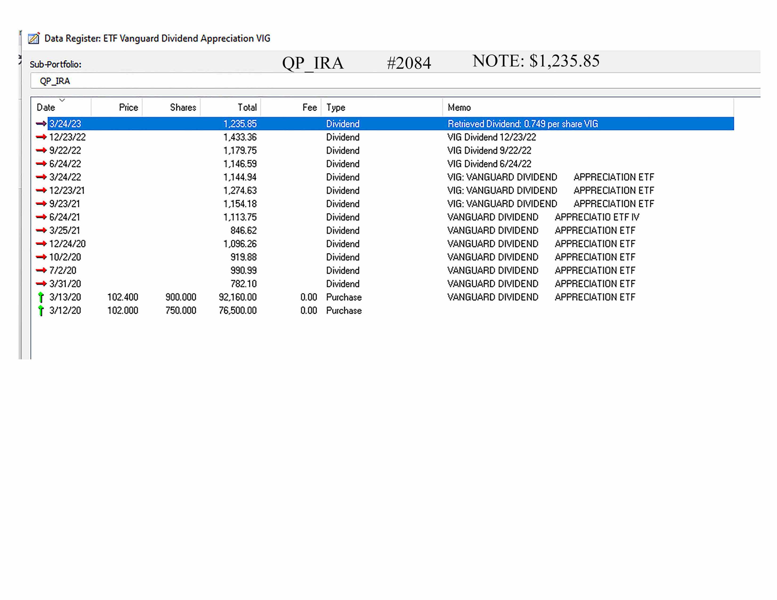

Over the past year I have experienced several instances of dividend transactions being downloaded to FM: (1) dividend as cash and (2) dividend as reinvestments.
All investments at Schwab are marked as NO (don't reinvest); in other words just send me the cash.
Yesterday a Vanguard ETF (VIG) paid a dividend of $1,235.85. The download transaction shows that amount as both a distributed dividend and a retrieved dividend. Since FM processed both transaction, the FM total exceeds Schwab's total by $1,235.85.
Hope you can help. We are heavily invested in dividend achievers, so almost every week when I reconcile FM with Schwab, I have a major headache to get the mess cleaned up.
You have been so effective in resolving this kind of transaction download problem, hope you can work your magic again.
Sincerely, Good_Vibe

I just see 1 distributed dividend in a a fund, and 1 purchase into a cash investment. That seems correct. Did you already fix it before making those screenshots?
Based on the memo for the distribution that says "Retrieved Dividend: 0.749 per share VIG" that appears to have been retrieved through Yahoo (Historical) instead of from Schwab. In the Pro/Adv versions when you use "Yahoo (Historical)" to retrieve prices, there is also an option to retrieve splits and distributions. If you're retrieving transactions from your broker, you don't want to also retrieve splits/distributions from Yahoo, as you will double count them. To prevent this, just un-check those options when retrieving using Yahoo (Historical).

No: Have not attempted to correct this problem yet. I retrieve all fund prices from the Yahoo Historical site but, to the best of my knowledge, nothing to do with dividends. All cash transactions (LTG, STG, Dividends, share purchase/sales) are supposed to
come only through the FM transaction download function via Schwab.
Schwab's web site when I log in does not show the VIG dividend of $1,235.85. The VIG share count and price in FM matches Schwab. So hopefully Schwab will perform per my instructions to send VIG dividends in cash only.
Should I just delete the "Yahoo" transaction to the cash bucket from FM? Deleting said transaction from the cash bucket will result in the account total for FM and Schwab in agreement (way I have been handling this problem).
Should I also delete the "Retrieved Dividend 0.749 per share VIG" from the VIG record in FM? How in the world can I prevent Yahoo dividends (or LTG, STG) from being downloaded in the future?
And also, how in the world did I trigger the dividend download from Yahoo in the first place? The only way I INTEND to retrieve ANY Schwab account transaction is via FM transaction download.
And how could you tell that the dividend action came from Yahoo? And can you discern why this just started happening in the last three or four months?
Thanks so much for you expertise and helpfulness! Sincerely, Good_Vibe

Postby Mark » Sun Mar 26, 2023 1:03 pm
Hi Good_Vibe,
If you do a price retrieve from Yahoo (Historical) in the Pro/Adv versions, you'll see this dialog:
Yahoo (Historical) retrieve options
Just make sure to uncheck the options:
Retrieve Splits
Retrieve Distributions
Yes, it sounds like you should delete both the distribution in the fund, and the cash deposit, and wait for it to come down through Schwab.
The "memo" field is different for distributions retrieved through Yahoo versus your broker, so that is how I can tell it was from Yahoo (Historical).
