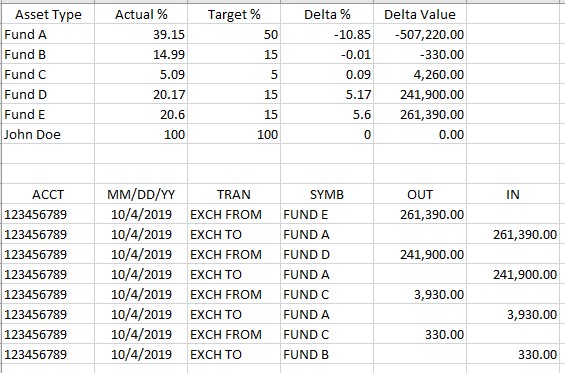

For mutual fund accounts it would be helpful if it could do the following (see below for images - I can't get things to line up):
Assume I rebalance and I get:
Investment Actual % Target % Delta % Delta Value
Fund A 39.15 50 -10.85 -507,220.00
Fund B 14.99 15 -0.01 -330.00
Fund C 5.09 5 0.09 4,260.00
Fund D 20.17 15 5.17 241,900.00
Fund E 20.6 15 5.6 261,390.00
John Doe 100 100 0 0.00
I would like to see something like the following exported trades:
ACCT,MM/DD/YY,TRAN,SYMB,OUT,IN
123456789,10/4/2019,EXCH FROM,FUND E,261390.00,
123456789,10/4/2019,EXCH TO,FUND A,,261390.00
123456789,10/4/2019,EXCH FROM,FUND D,241900.00,
123456789,10/4/2019,EXCH TO,FUND A,,241900.00
123456789,10/4/2019,EXCH FROM,FUND C,3930.00,
123456789,10/4/2019,EXCH TO,FUND A,,3930.00
123456789,10/4/2019,EXCH FROM,FUND C,330.00,
123456789,10/4/2019,EXCH TO,FUND B,,330.00
Annotation 2019-10-04 103402.jpg (78.43 KiB) Viewed 5784 times

Postby WeekendRider » Fri Oct 04, 2019 8:45 am
In the image the column heading should be Investment and not Asset Type.
Okay, so the key feature you're looking for is that the trades are all equal value/opposite? The way it works now you can get the sums of all the trades to net to $0 effect on cash, but in your example all the buys of Fund A would be lumped into a single transaction.

Mark wrote:Okay, so the key feature you're looking for is that the trades are all equal value/opposite? The way it works now you can get the sums of all the trades to net to $0 effect on cash, but in your example all the buys of Fund A would be lumped into a single transaction.
Yes, that would be awesome!
