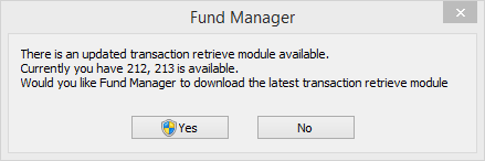

Postby Ivan » Tue Oct 27, 2015 4:47 pm
No prompt to run in administrator mode comes up. I do get the shield on the OK button, but there is no succeeding prompt to run in administrator mode. Below are the prompts I get in sequence.
Fund Manager1.png (5.49 KiB) Viewed 5479 times

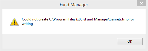

When I click "Yes" on the above it goes directly to the "Could not create..." error message below.
Fund Manager2.png (5.18 KiB) Viewed 5479 times

Postby Mark » Tue Oct 27, 2015 4:54 pm
Hi Ivan,
Is the user that you're running Fund Manager with an Admin or a Standard user?
Posts: 11847
Postby Ivan » Tue Oct 27, 2015 5:01 pm
Standard.

Postby Mark » Tue Oct 27, 2015 5:04 pm
Hi Ivan,
This is the problem. The user you run Fund Manager with has to be capable of elevating to an Admin, so it can write files into the Program Files area. Try running FM with the same user that you used to install it, and do the update as that user.

Postby Mark » Tue Oct 27, 2015 9:34 pm
Hi Ivan,
Try starting FM as an admin, doing the update, and then exiting. Run it again regularly as your Standard user. That should allow you to complete the update.

Postby Mark » Wed Oct 28, 2015 10:07 am
Hi Ivan,
Yes, I can explain what is going on. First, in order to write a file into the Program Files directory you need to have Admin permissions. When Fund Manager attempts to do the update, and you see that little shield icon on the "Yes" button, it launches a separate program to do the update. That program requests "highest available" permissions for the current user. If that user is only a Standard user, that is the highest available for that user. You won't be prompted to switch to a different user that has Admin permissions. If the user is an Admin, but running FM with Standard permissions (this is the most common configuration), the permissions will be elevated to Admin level (after a prompt), and the update can succeed.
We could make that program request "requires admin", in which case your Standard user would be prompted to log in as a different user with Admin permissions. However, this means a Standard user who chose to install it to a directory other than Program Files couldn't do the update if they weren't able to log in as an admin. We chose the "highest available" requirement for this program to give the most flexibility, but it does mean that someone in your situation would have the update fail when running as that Standard user.
By starting FM as an admin user to start with, you are then able to elevate to admin permissions to do the update, and you don't get an error.
After writing all of this, I think we should probably change this requirement to "requires admin"... This is the same requirement in order to install the program, so we're not really giving any more flexibility by keeping this update program at "highest available". We'll plan to make this change for the next release.
