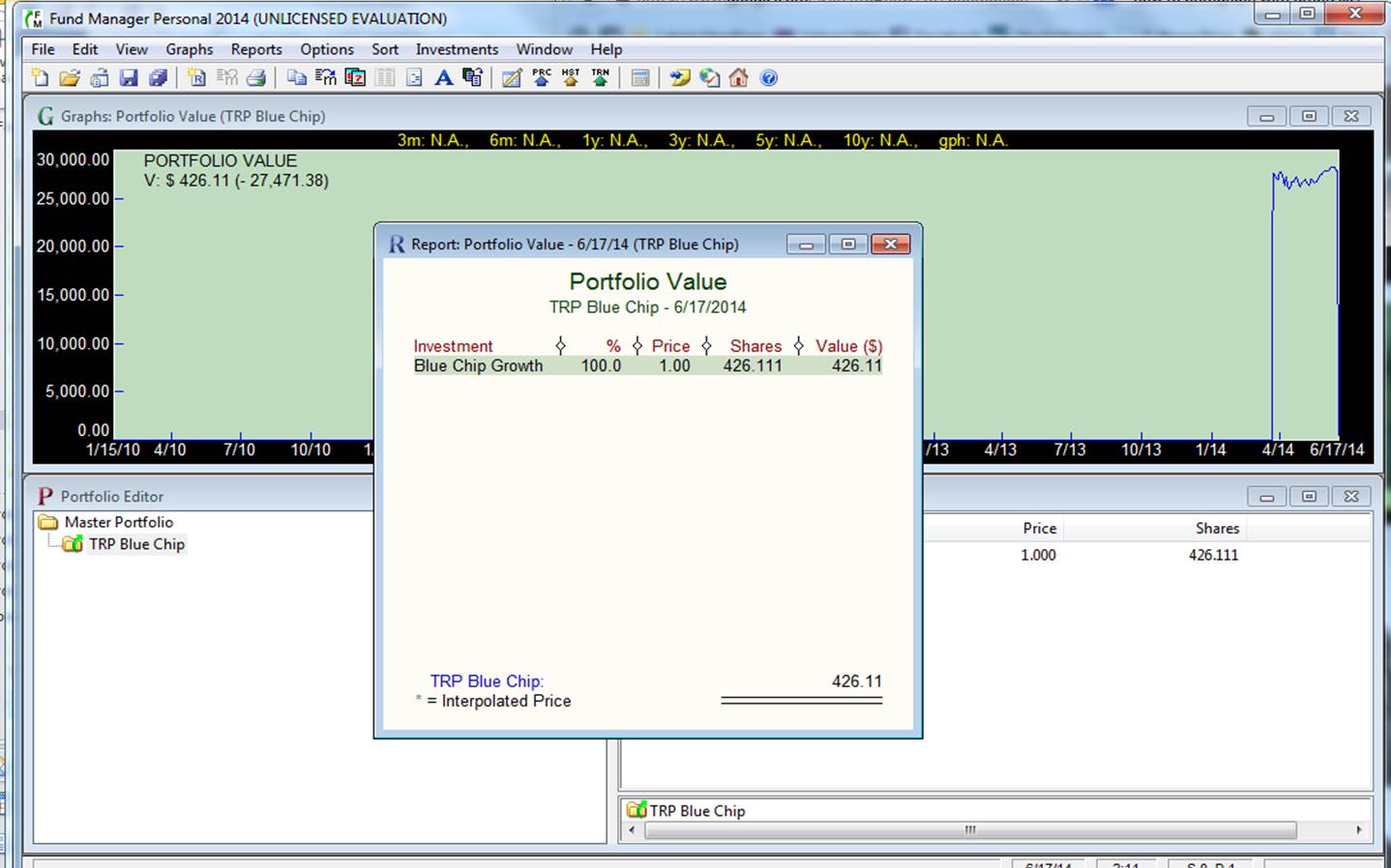

Postby robvasi » Tue Jun 17, 2014 12:51 pm
It has the correct number of shares but the share price shows as $1.00. I did something wrong, but don't know what. I will try again.
Tried it again; same result, price is one dollar. I know I asked it to download historical prices.
