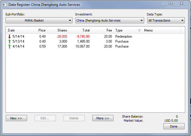

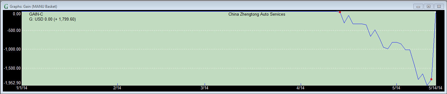

Hi Mark
as soon as I close a position or a part of a position the Gain Graph calculates the gain to zero for this position or this part of position. e.g. buy at 1000 sell at 900 and the gain graph shows zero for the selling day

Hi samuel,
You are selling all your shares, and plotting the "Current" gain. This is the gain of your currently held shares. Since you own none, the gain is zero. If you want to see the "Historical" gain, select "Graphs / Options / Historical Cost" while the input focus is on your graph window. The historical gain will include the all your realized gains/losses back to inception. To read about this in more detail, select "Help / Help on Graph...".
