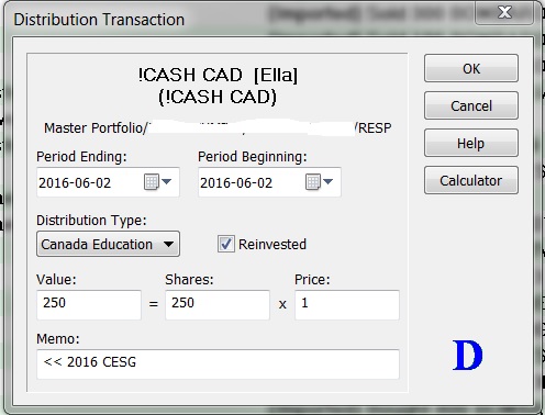

Postby ThomasK » Mon Jul 25, 2016 8:09 pm
showing the distribution ticket filled out
Distribution Transaction CESGrant.jpg (55.41 KiB) Viewed 3792 times

Regarding the previous answer, I'm thinking about what you said that a dividend is linked to the stock for performance purposes...BUT as the CES Grant is just 'free cash' I'm now thinking that it's better to consider it as a form of 'interest' and not as a dividend as I said in my previous post.
Question 1:
Either way, I also need to keep the other headings of Dividends for dividends and Interest as interest. So, by inputting the CES Grants as "User-defined 1" (Original Label) am I correct that on a custom report I WILL be able to show those dollar amounts as a separate item?
And, if I'm going to go the route of considering the grant as if it was interest BUT I want to use a separate heading of the User-defined 1 to keep track of the government free money I'm seeing that I need to complete the ticket as attached. Checking off "Reinvested" is the only way to actually increase the cash balance...
Question 2:
Mark, you said earlier in a different thread:
A distribution transaction can be either "distributed" or "reinvested". If it is distributed, the money was just paid out (or put in if negative). If it is reinvested, no external money flowed. Instead, the money was used to buy more shares (or shares were redeemed to pay for a negative distribution).
Since you are trying to record account fees that came out of cash, you want to record a negative value distribution, and mark it as reinvested, so that shares of cash are redeemed to pay for it. If you didn't mark reinvested, the cash balance would not change, and it would be like you had sent it a check to pay for the fees.
Reading the above previous statement sounds like I should NOT be using "reinvested" as there was indeed an external flow. Also, reading the above statement, marking it as reinvested would NOT change the cash balance, but as the image of the ticket shows as marked reinvested, that in fact DOES increase the cash balance.
I apologize for not understanding the above and how it fits into me using User-defined 1 for the distribution transaction, but why if it is NOT checked as Reinvested does the cash balance not change? What is FundManager thinking the $250 is? I'm thinking that it would basically be a meaningless entry?? There WAS external flow of cash into the account, so the above statement either is incorrect or there's something afoot with how FM handles User-defined 1??
Is it me, the statement in italics, or how FM calculates from Dividend, Interest, User-defined 1 that I'm just not understanding?
Thanks Mark.
Postby Mark » Tue Jul 26, 2016 8:51 am
Hi Thomas,
1) You can record many different types of distributions: Dividends, Interest, user-defined, etc. They all work they same, but are just separated for reporting purposes. Your re-named user-defined distribution type is identical to Interest and Dividends, it is just put in a different category, so you can get a total/etc for just this one type of distribution, separate from your other distribution types. They all work the same as far as reinvestment options, and their effects on your performance numbers.
2) You didn't pay any money for these additional shares, so from that point of view there was no external cash flow. The money actually came from the government. By recording it as a reinvestment you are giving the credit for these funds to the underlying investment. You can either record this as a buy or a reinvestment to obtain more shares. If you stick with recording it as a reinvestment it is like the investment generated this money, and you put it back in for more shares. You could also record it as a buy, but then you can't categorize it separately from your own additions.
