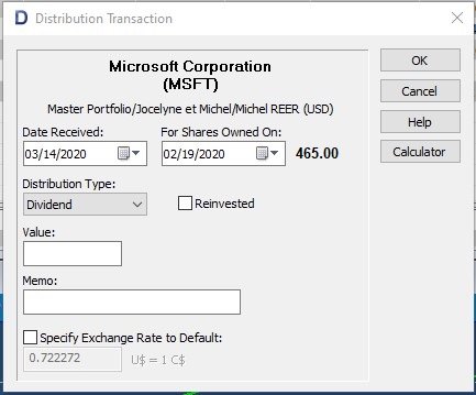

Postby MichelV » Sat Mar 14, 2020 5:38 am
I agree with Djobydjoba. I might even go further and skip the "Shares owned on:" hiding all together. Agreed that Mutual funds will use the distribution date as the "Ex-date" but that can easily be resolved by making "Date received:" and "Shares owned on:" the same.
I stumbled on this post as I was entering a Dividend and since I had made some recent changes I was wondering how many shares I owned on the Ex-date. I easily found the answer with a report but since FM has the way to extrapolate that information at any time, I taught it would be great to have the information available asper the attached mock-up. (Date received ended-up being the 12th but you still get the idea)
Share owned on.jpg (39.73 KiB) Viewed 3045 times

Postby Mark » Sat Mar 14, 2020 9:00 am
Hi MichelV,
Understood, thanks for the idea.
