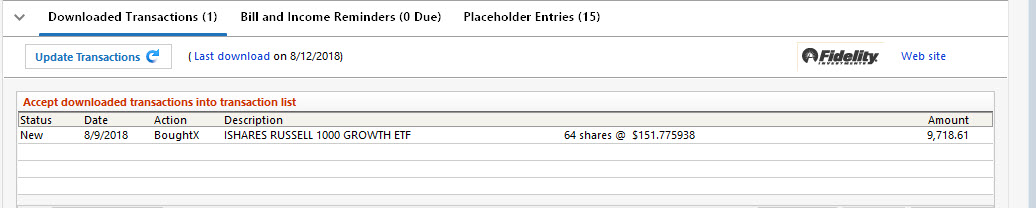

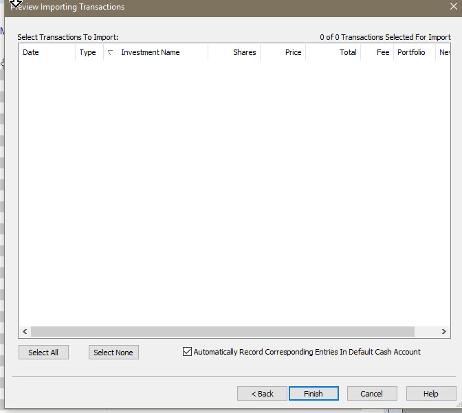

OK, I am attaching some images of my experience this week. One shows my Quicken download of a new purchase. Next is my FM update, which did not find that purchase. So I manually entered it.

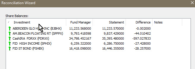

Then I did another request to download new transactions, pushing the date back to 7/30. My third image shows that FM found numerous bond fund reinvestments which it had apparently missed before.
So this is my problem. I have updated several times in the past week, but it never saw those reinvestments. Would it normally take 12 days for those to be visible? THey show up on the Fidelity site the same day they are distributed.
My hypothesis is that there is some reason it skips them when they first appear, but then later on, it overlooks them because it thinks it has already "seen" them or something.
FM Transaction Download same day as Quicken.jpg (51.37 KiB) Viewed 4530 times
QuickenDownloadsISharesFund 08-09.jpg (60.16 KiB) Viewed 4530 times

-Mark, my images were posted in the opposite order that I submitted them, so the first image shows the FM Reconcile page with a handful of dividend re-investments that it had not picked up earlier.
That image is showing the Reconciliation wizard. That shows your share balances in FM and on the statement. It is not showing any transactions. Reconciling is a separate command from retrieving transactions. Maybe you meant that you can see from the share balances it is missing some transactions? That Reconciliation wizard does not show any transactions though, just share balances.

Sorry I was not clear. Yes, the first image is from the reconciliation wizard, and you are right that in my message explanation of the image, I jumped immediately to the conclusion that FM had missed all those dividend re-investment when I had last updated it.
