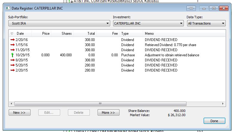

The dividend of CAT in the attachment was imported as a transaction from the broker but does not appear in the default cash account. No the cash account in FM is off by this amount. Do I need to wait longer for it to appear in the downloaded cash account or examine my settings?

If the dividend wasn't added to your cash account, check the properties of the sub-portfolio for this account, and make sure the "Default Cash Account" is assigned. It has to be assigned at the time the transaction is entered/imported/retrieved in order to create a default cash account entry. You can correct it by just recording the cash side of the transaction manually. Enter a buy of cash with the price at 1, and the number of shares equal to the value.
Also, it appears you may have a duplicate dividend there. You can get transactions from retrieving transactions from your broker, and also when using the "Yahoo (Historical)" quote server, and choosing the option to retrieve dividends. If you're retrieving transactions from the broker, you do not want to also retrieve dividends from Yahoo for that same account. Based on the memo difference, the dividend on 1/15/16 may be a duplicate, and from Yahoo. The others look to be from your broker.

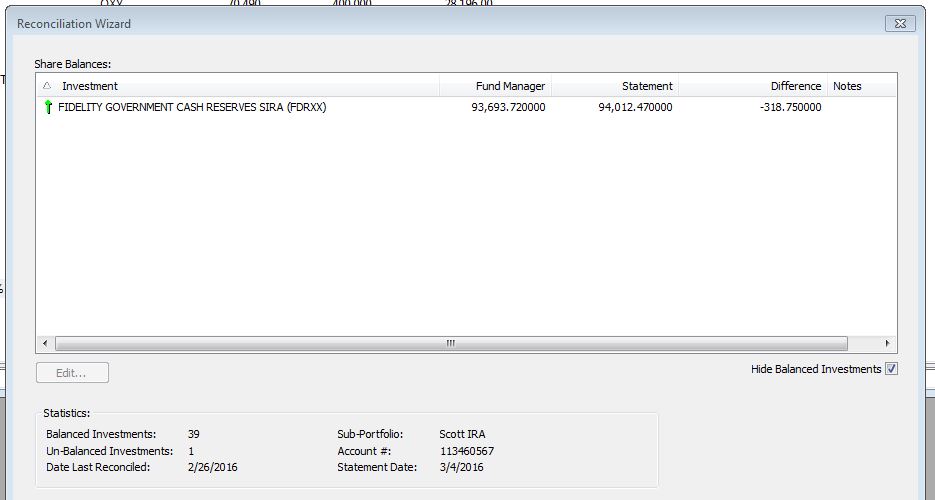

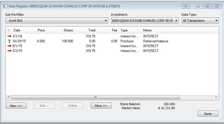

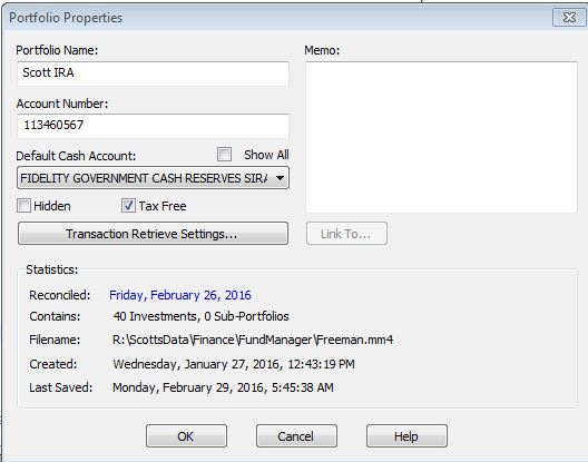

Here's a newer example of a cash payment that doesn't seem handled properly. In 'Interest Received.jpg' the bond pays interest. A cash account had been assigned prior to this as shown in "Cash Account Assigned.JPG". Running the reconcile show that FM cash "Reconcile off.JPG" is off by this amount. I can't tell where FM has put the cash shown in 'Interest Received.jpg'.

Take a look at your cash account in the Data Register, and see if it is missing a corresponding buy for the interest paid by your bond. If so, just add the buy transaction into cash. It may be that the cash account was not assigned as the default cash account when the interest payment was recorded in Fund Manager. It has to be assigned at the time the transaction is retrieved/imported/entered in order for a default cash entry to be created. You can also convince yourself that it is working now by manually recording a new test interest transaction in the bond, and verifying the cash entry is created properly. Delete the test entry after you're done.

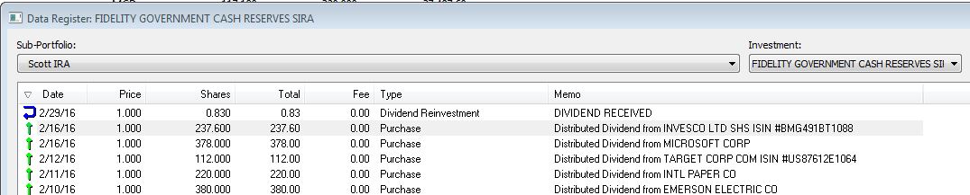

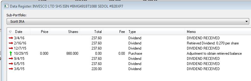

Attached is another example. The Invesco entry from 3/4 was pulled from the 'retrieve transactions' and is not transferred to the cash account. There also appears an entry on 2/16 for what is probably the same dividend and this is recorded in the cash account. I'm not clear where the 2/16 entry came from. If I log on to the brokerage account from the web the 2/16 entry is not there, only the one from 3/4. Is FM pulling dividend information from somewhere other than the brokerage account?

If cash entries are created when you manually record, but not when you retrieve, then check the option on the last page of the retrieve wizard. This is the "Preview Importing Transactions" page, and at the bottom there is an option "Automatically Record Corresponding Entries in Default Cash". Make sure this option is checked. It sounds like it is not checked now based on your description of this issue.
For the extra dividend transaction, that was retrieved from "Yahoo (Historical)". Note, when you retrieve historical prices from this server (and you're using Professional or Advisor), there is an option to retrieve dividends and splits. If you're already retrieving dividends for an account from your broker, then you would not want to also retrieve them from Yahoo. Just un-check that option when retrieving historical prices.
