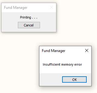

I have the Fund Manager software installed on my home PC and on my work PC and when I try to print my reports I am getting an error message that there is insufficient memory and the printed report is BLANK. Have tried printing to a printer and also printing to a PDF and I get the same message.

I read through the threads for "Insufficient Memory" and notice that my issue was not covered.
I'm trying to print a memorized Custom Report that I've printed before but now I get either:
a. an "Insufficient Memory" error and no display
b. a display of the Preview but prints a blank page
c. when I unchecked "Scale Down" it will print but of course truncates rightmost columns.
HOWEVER, a newly opened Report (it's memorized) prints OKAY.
Sure, I can simply close the offending report and reopen it but I'm wondering if there is some sort of permanent fix. Not a big deal but I thought you might have some insights as the issue comes and goes.

I too have the Insuffisent Memory Error pop-up with a Report Print Preview or when launching the printing to the Microsoft Print to PDF printer.
The report is a Portfolio Performance report (not custom) with maybe 200 lines.
My computer has 32 GB of RAM, 15Go used currently...

I can't reproduce the problem anymore. A few days ago he often repeated. What I noticed then:
- It was working with lighter reports (less lines)
- It was working with "File / Page Setup... / Scale Down to 1 Page Wide When Necessary" turn off, but not when turned on.
- It was working with Exchange Rate Adjusted ON, but not with Exchange Rate Adjusted OFF (I played at least 5-6 times with this setting to confirm, I was happy to find this but, maybe after a FM restart, the problem has gone).
My screen resolution : 1920*1200
I can't reproduce it now, I will try again in the future (even if it's not a feature I use much)
