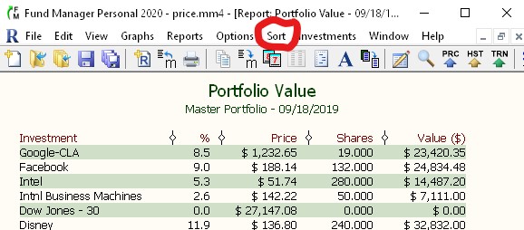

Postby Mark » Fri Jan 22, 2021 5:14 pm
Hi Jim,
You see "Reports" on the menu, right? It is that same menu, but while you have a report window open, you'll see a "Sort" menu item in the same menu as where you chose "Reports". For example, it will look like:
Sample Report Showing Sort Menu
Screenshot 2021-01-22 171203.jpg (52.19 KiB) Viewed 11498 times
Posts: 11815

Postby Mark » Thu Jun 27, 2024 8:46 am
It sounds like you are sorting the report by "Investment Stack". What type of report and what settings are you using for listing? The "Sort" menu sorts the report, but if you are sorting by "Investment Stack" (which is the default), then the "Investments / Sort" menu will affect the sorting of the report, as that menu command changes the investment stack order.
Maybe you can email me or post some screenshots illustrating the problem.
