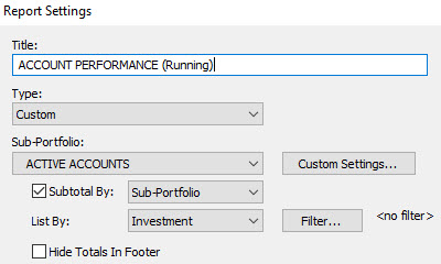

My Report Settings:
FM example of Report Settings.jpg (30.53 KiB) Viewed 2060 times
I'm using USD as my Default in my thinking for a few reasons, mostly as I chart whenever possible the US version of the holding and also that I like clicking on the "Exchange" button and SEE IT BLUE so that I know I'm looking at USD. Arithmetically and how I'm tracking all seem perfectly fine, but...

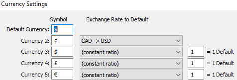

QUESTION 2:
Did using the ALT symbol 0162 "¢" as the symbol in the Currency Settings window cause an issue?? I also might have used alt-36 for the $ instead of typing the shift-4.
QUESTION 3:
Will using USD as my Default currency cause a problem with currency converting and TAX TIME?
FM example of Currency Settings window.jpg (30.28 KiB) Viewed 2060 times

I didn't quite understand the first picture of a report. It looked unrecognizable... However, if you want to know the reason for an N/A, you can usually find it by selecting "Help / Logs / Report Calculation..." from within that report.
The symbol you assign to a currency should not cause any issues. You can use whatever you want.
I don't see USD in your currency settings. I see $. Is that what you mean? What problem are you concerned about at tax time?
