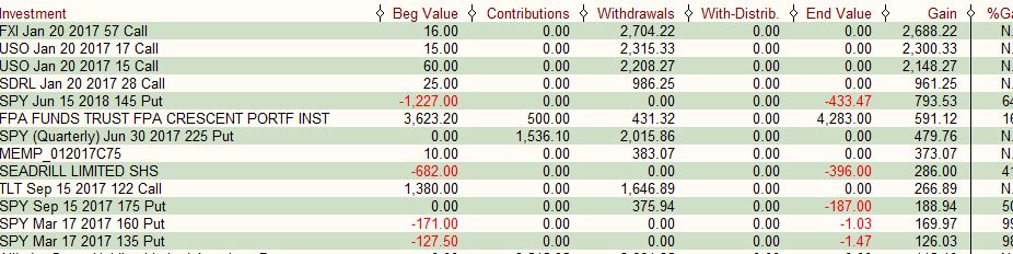

I'm having a confusing issue with the performance report. I have a couple of options that just expired which gave me a loss, but they're showing as a gain in the performance report. I'll attach a snapshot of what I'm talking about, but I can't figure out what's wrong.
In the attached snapshot I'm talking about the top 4 investments... FXI, USO, USO, SDRL. Those were all complete losses. I bought those options over a year ago for the full amount that is now showing as a gain. It seems like that figure should be either under the Beg. Value or Contributions tab. Instead the contributions are all zero and tiny amounts for the Beg. Value... ($16 for FXI Jan 20 2017 57 Call)
Several lines below that I also this happening with the SPY Sep 15 2017 175 Put. Any Idea why these are incorrect? Thanks

Hi chancee,
Look at what transactions you have recorded. Also, notice the Portfolio Performance report can be for any date range, so it is important to consider where that report is starting/ending. This determines what is in the contributions/withdrawals columns, versus the beginning/ending columns.
From that report I can see you took out a bunch of money (2704.22) during the period, started with a small amount (16), and ended up with no value. Given just this information, that is why you have a large gain reported. The question is what transactions do you have recorded. If the option expired worthless, you shouldn't have a large withdrawal. The beginning value on the report's starting date is only 16, so why is that? Investigate this in the Data Register. The Beg Value is the market value at the beginning of the report's date range. This is the number of shares owned times the closing price. Why do you have a large withdrawal during the period? This looks like a sell or transfer out transaction for that large amount.
If you need more help, show the date range of this report, and all the recorded transactions for a given investment in question.

Thanks for responding... The thing is, I actually didn't take out any money. How could I? It was an option. I agree, with the option expiring worthless, I shouldn't have a gain whatsoever. I bought these options over a year ago... and the report only covered this year. From Jan 1 until now. These options did not lose this much value in a month and a half, nor was the value withdrawn somehow...

I understand that in reality you didn't take money out, but somehow you have a transaction recorded that is taking money out. Look at your transactions recorded within the date range of the report. Use the Data Register.
